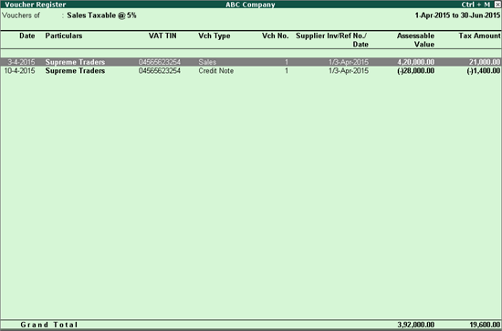

To view all the sales transactions
●      Select any of the rows displayed in italics, under Local Sales or Interstate Sales.
●      Press Enter.
Voucher Register screen appears as shown below:

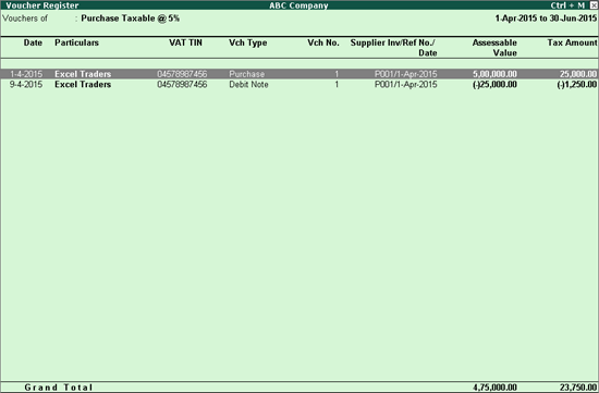

To view all the purchase transactions
●      Select any of the rows displayed in italics, under Local Purchases or Interstate Purchases.
●      Press Enter.
Voucher Register screen appears as shown below.
