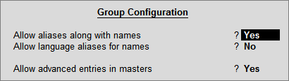

  1. Go to Gateway of Tally > Accounts Info > Groups > Create (Single Group).
  2. Select F12: Configure (Group Configuration) and enable Allow advanced entries in masters.
The group creation screen with advanced options is displayed as shown below:

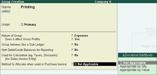

In the Group Creation screen
  1. Enter a name for the group.
  2. Enter a group category. If a group is created under Primary you must select from asset, expenses, income or liability.
  3. Select the Nature of Group.

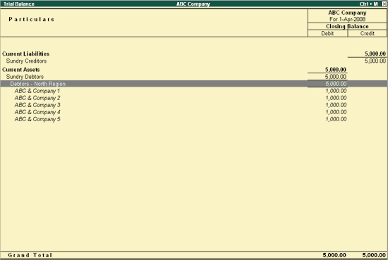

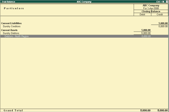

  4. Select Yes for the option Group behaves like sub-ledger? to allow groups to act as a ledger.
  • When the option Group behaves like sub-ledger? is set to Yes, the ledgers grouped under the same is not displayed in detailed mode.
  • When the option Group behaves like sub-ledger? is set to No, all the ledgers that are grouped is displayed in detailed mode.
  1. Set Nett Debit/Credit Balances for Reporting? to Yes to display net debit or credit balance in the report (whichever is higher).
  2. Set Used for Calculation (e.g. taxes, discounts)? to Yes if ledgers under this group have percentages for discounts or taxes to be used in invoice entry. This is displayed while passing voucher in invoice mode and for automatic calculations.
  3. Select Method to Allocate when used in Purchase Invoice from the Allocation Methods list to allocate the expense of the item in the ratio of the quantity or value.
