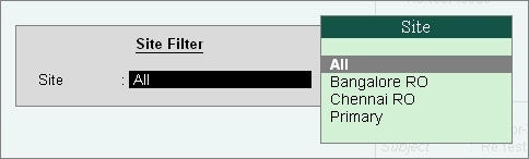

  • Click on F8: Site Filter provided in the buttons toolbar or press F8, to select the Site from the list.
Site Filter - All
  • Select the option All under Site to display all the queries/ issues, of all the Sites/ Locations based on the Group by option selected.

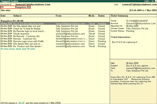

  • Select a Site, say 'Bangalore RO’ from the list of Sites to display the query list pertaining to the selected Site, as shown:

In case you have selected a Site, from the list of sites by pressing F8: Site Filter, the query list will display the Site ID on the  top left (below the Account ID) in the Support Centre screen, as shown.
