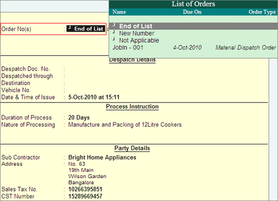

  3. In Party Details screen, in Order No(s) field select End of List.
Note:  In Order No (s) field, End of List is selected, as the Job Worker is not transferring out the finished goods, he is only moving the stock from one godown to another godown with in the factory.

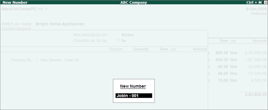

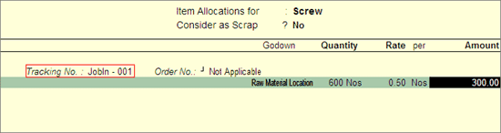

  • Tracking Number: Job Worker is using his own stock to manufacture the goods. The goods consumed will be billed for the Principal Manufacturer. Hence to track the Raw Materials in sales invoice tracking Number has to specified. Select New Number & specify the tracking as - JobIn - 001. indicating that these raw materials are consumed to manufacture goods of order JobIn - 001
  • In Godown select the godown from where the stocks are transferred. Enter the Quantity & Rate of stock transferred.

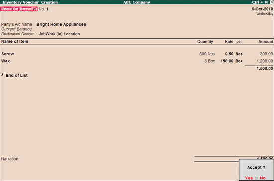

  1.  In Name of Item field select the stocks which are own consumption of the Job Worker. Select Wax. In Item Allocation screen, enter the Tracking Number (JobIn - 001), select the Godown (Raw Material Location)and enter the Quantity (8) & Rate (150).
The completed material out voucher is displayed as shown
  1.  Press Enter to save.

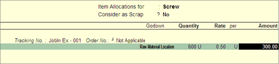

  1. Tracking Number: Job Worker is using his own stock to manufacture the goods. The goods consumed will be billed for the Principal Manufacturer. Hence to track the Raw Materials in sales invoice tracking Number has to specified. Select New Number & specify the tracking as - JobIn Ex - 001. indicating that these raw materials are consumed to manufacture goods of order JobIn Ex- 001
  • Select the godown, Specify the Quantity & Rate of Item transferred

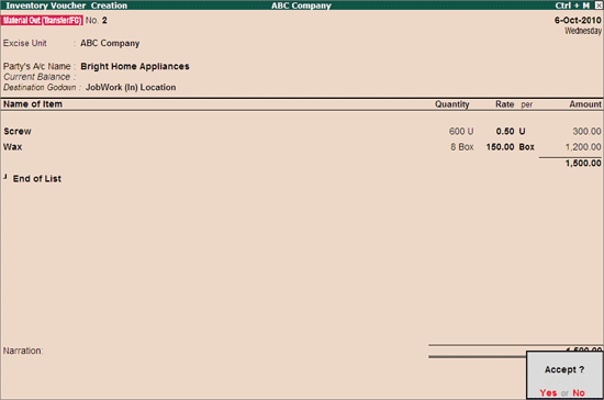

  1.  In Name of Item field select the stocks which are own consumption of the Job Worker. Select Wax. In Item Allocation screen, enter the tracking Number (JobIn Ex - 001), select the Godown (Raw Material Location)and enter the Quantity (8) & Rate (150).
The completed material transfer out voucher is displayed as shown
