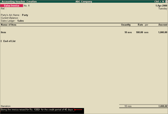

  1. Enable Use Common Narration to give a common narration for voucher.
A common narration screen for voucher appears as shown below:

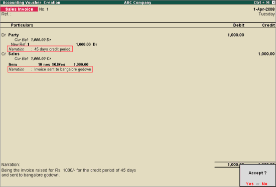

  1. Enable Narrations for each entry if you want to give a separate narration for each entry of a voucher. This would be applicable for a multiple entry voucher where you want separate details for each entry.
The narrations for each entry appears as shown below:
For Delivery Note, Receipt Note, Sales order, Purchase order, Physical Stock, Stock Journal, Rejection In and Rejection Out, the option Narration for each entry is not available.

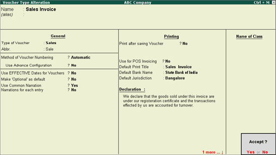

  3. Create a voucher class in the Name of Class field, if required.
The completed Voucher Type Creation screen appears as shown below:

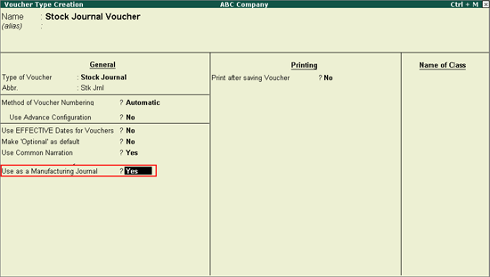

Stock Journal Voucher Type
While creating a Stock Journal Voucher Type, the option Use Manufacturing Journal is enabled.
The Voucher Type Creation screen appears as shown below:
