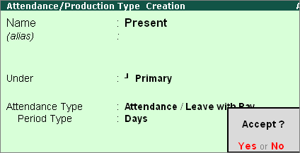

To record positive attendance type named Present to
  1. Go to Gateway of Tally > Payroll Info. > Attendance/Production Types > Create.
  2. Enter the Name of the Attendance Type.
  3. Select Primary from the list for the field Under.
  4. Select the Attendance Type as Attendance/Leave with Pay. .The Period Type appears automatically.
  5. Press Enter to save.
Note: You can also create the Attendance Type Absent as Leave without Pay for recording negative attendance in the same manner.
