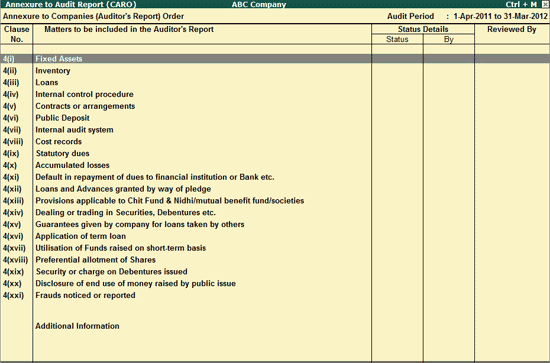

Annexures to Auditor’s Report (CARO) has been added to Tally.ERP 9 to enable auditors to adhere to this checklist consisting of 21 clauses, covering the items that are required to be included in the Auditor’s Report.
To view the report
Go to Gateway of Tally > Audit & Compliance > Audit Documentation > Annexures to Auditor’s Report (CARO).
The report is displayed as shown below:

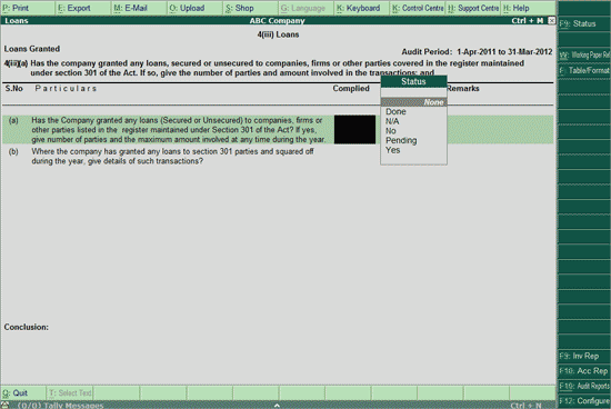

• To drilldown into the checklist for the sub-clause, place the cursor on the required sub-clause and press Enter
Click here for Checklist screen
• The auditor can specify whether the items in the checklist have been complied with, using the options in the Status list under Complied column
• Observations and comments can be recorded in the Remarks column
• Conclusion drawn based on the auditing conducted as per the checklist can be recorded here. An option to fill in the Conclusion field with pre-defined text has been provided in Tally.ERP 9. The user can also create and save Conclusions to be filled in and the same can be used for filling the field.

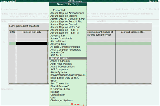

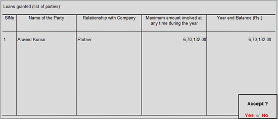

F: Table/Format
This option has been provided to record details to be provided with CARO.
Press Alt+F or click on F: Table/Format.
The Table appears (in this case, Loans Granted):
Choose the Party Ledger concerned, press Enter.
Specify Relationship with Company, Maximum amount involved at any time during the year, and Year end Balance (Rs.)
Press Y or Enter to save the entries made in the table.
Note: F: Table/Format option is available only for Clauses 4(iii)(a), 4(iii)(e), 4(ix)(a), and 4(ix)(b).

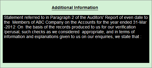

At the bottom of the main screen, Additional Information is provided.
Place the cursor on Additional Information and press Enter.
The Additional Information sub-screen appears. It comes pre-filled with text that will appear at the beginning of the printed report.

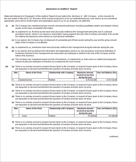

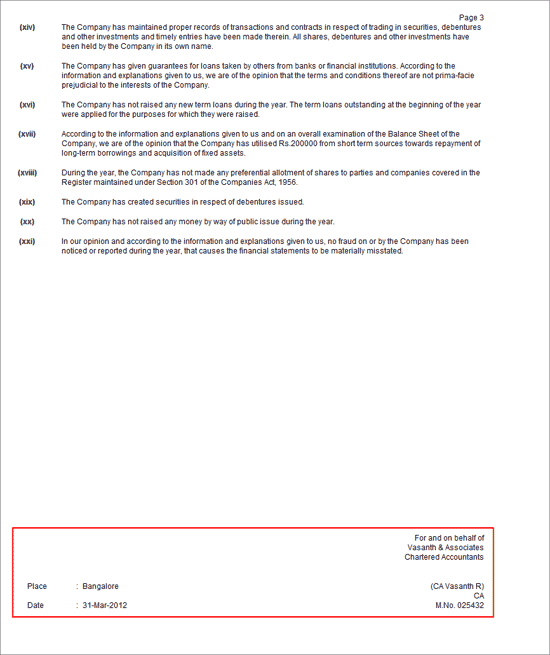

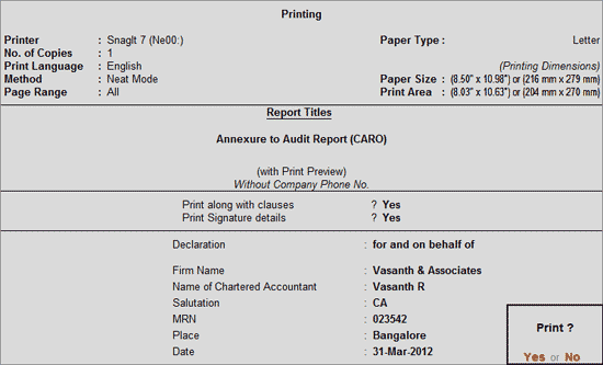

To print CARO
Click on P: Print or press Alt+P.
The Print Report screen appears.
To print the report along with the clauses and Signature details of the auditor press Backspace.
To print the clauses, set the option Print along with clauses? to Yes.
To print the signature details for the auditor, set the option Print Signature details? to Yes.
Fill in the Declaration, Firm Name, Name of Chartered Accountant, Salutation, MRN, Place, Date, and so on.
Press Y or Enter to print CARO.
At the bottom of the last page, the auditor's Signature Details will be printed:

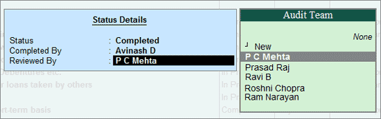

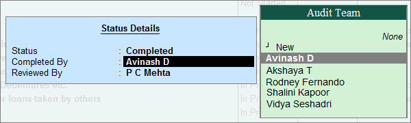

To enter the audit status for a sub-clause
Place the cursor on the required sub-clause and press Spacebar to select it.

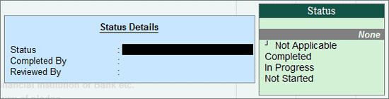

Click F9: Status or press Alt+F9.
The Status Details sub-screen appears as shown below:
Select Status for audit with reference to a particular sub-clause as None, Not Applicable, In Progress, or Not Started, as required.
Select Completed By from the names of the Audit Team member who performed the auditing.
Select Reviewed By from the names of the Audit Team member who reviewed the auditing.

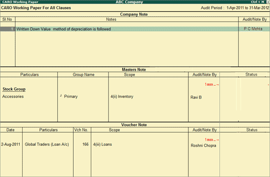

Audit Working Notes, utilized as a means of reference for audit work performed, can be marked for CARO Reporting. Working Notes added at Company, Master, and Voucher Levels and tagged for CARO Reporting will be displayed in CARO Working Paper. To view CARO Working Paper, press Ctrl+W.
