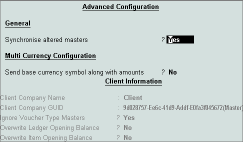

Advanced Configuration for Send Data
The Advanced Configuration screen appears as shown below:
To define the advanced configuration
  • Set Synchronise altered masters? to Yes to synchronise changes on masters altered since the last synchronisation.
  • Set Send base currency symbol along with amounts? to Yes to send the base currency symbol of the company to the server.
Client Information contains details of the client rule set.

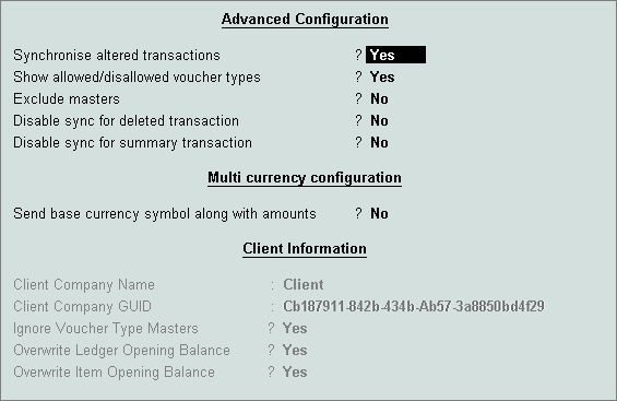

  • Set Synchronise altered transactions? to Yes to synchronise changes to transactions made post synchronisation.
  • Set Show allowed/disallowed voucher types? as Yes to display the allowed/disallowed voucher types.
  • Set Exclude masters while sending to Yes to leave out dependant masters along with transactions.
  • Set Disable sync for deleted transaction? to Yes to leave out deleted vouchers for synchronisation.
  • Set Send base currency symbol along with amounts? to Yes to send the base currency symbol to server company.
  • Client Information contains details of the client rule set.
