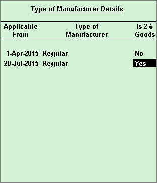

Enable the option Deals with only 2% Goods.
Click L: Details to define the date of applicability for dealing with 2% goods.
Enter the date in the field Applicable from.
Select the Type of Manufacturer.
Select Yes in the field Is 2% Goods.
Set applicability details for the next period, if required.
Press Enter to go to the Excise registration details screen.
