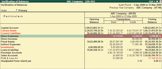

  1. Go to Gateway of Tally > Audit & Compliance > Audit & Analysis > Verification of Balances.
  2. Bring cursor on the amount field for the required Group as shown below:
  1. Press Enter.

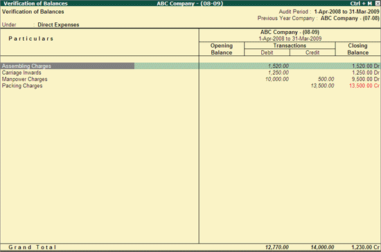

Verification of Balances report for the selected Group will be displayed as shown below:
The drill down reports and button options are same as the Verification of Balances report.
Drill down to Ledger Vouchers report is provided from the above report by keep pressing Enter on the Group name or a Subgroup name and then Ledger name.
