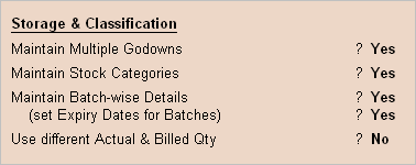

Advance mode means enabling advance configuration and Features for stock item master in F12:Configure and F11:Features.
Shown below are the advance configuration parameters  for stock item master under F12:Configure (Master Configuration) :
 Shown below are the advance Features for stock items in F11:Features:
Note: You can configure the entire setup according to your requirements. According to the configuration in F12 and F11, stock item master fields will get added and removed.

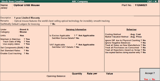

Go to Gateway of Tally > Inventory Info > Stock Items > Create (under Single Stock Item)
A brief description of each additional field in Stock Item Creation screen is given below.
Part No.
This Part number field gets enabled only after enabling Use Part Number for stock items in Inventory Master Configuration. This field is used to enter the Vendors catalogue number. You can also optionally print it in reports/invoices.
Description
The Description field gets enabled only after enabling Use Description for Stock Items in Inventory Master Configuration. This field is used to enter the description of the Stock Item as it is required to be printed in Quotations, Delivery Challan/Invoice.
Remarks
This Remarks field gets enabled only after enabling Use Remarks for Stock Items in Inventory Master configuration. This field is used to enter Remarks for the Stock Item (for internal use only). Any additional details about the Item can be entered here.

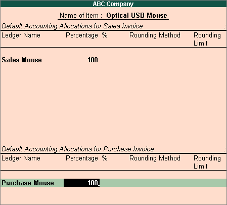

Set/Modify Default Ledgers for Invoicing?
This option gets enabled only after enabling Specify Default Ledger Allocation for Invoicing in Inventory Master Configuration. Once you enable this option, a  screen will be displayed for selecting the default ledger allocation for sales and purchase for the stock item.
Note: This option is useful only in case of Invoice entry through Voucher Class.
Category
This Category field gets enabled only after enabling Maintain Stock Categories in Inventory Master Features. This field will show the List of Categories. Here you can select the Stock Category under which the stock Item belongs. By default, Not Applicable is displayed in this field.
Note: You can create a new stock category by pressing ALT+C at this field.

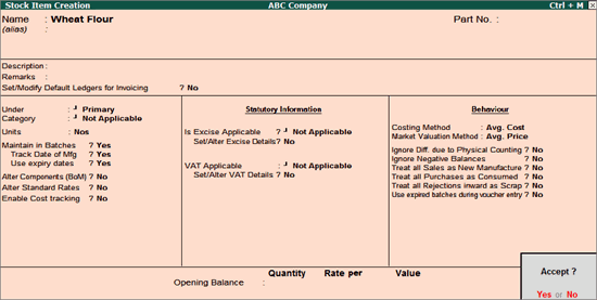

Alternate Units
Alternative Units are individual units similar to simple units, which can be used instead of another simple unit during Invoicing / voucher entry and are also useful in displaying the stock reports alternatively in another simple unit. This is particularly useful when you need to handle different units at different times.
This Alternate Units field gets enabled only after enabling Use Alternate Units for Stock Item in Inventory Master Configuration.
Example:
Wheat Flour bag of 1 Kgs can be sold in Nos and the weekly /monthly sale or tonnage of wheat flour can be measured in Kgs or vice versa. Here, in this both Nos and Kgs are simple units, which can be alternatively used.
Maintain in Batches?
This option gets enabled only after enabling Maintain Batch wise Details in Inventory Master Features. If you want to maintain the batch information of Stock Items, set the option Maintain in Batches to Yes.
Track Date of Mfg?
This option is enabled only when Maintain in Batches? is set to Yes. If you want to specify the manufacturing date for the item, set Track Date of Mfg. to Yes.
Use Expiry Dates
This option gets enabled only after enabling Set Expiry Dates for Batches under Maintain Batch Wise Details option in Inventory Features. If you want to specify the expiry date of the item, set Use expiry dates to Yes. This option is useful for stock items like medicines, Food items, etc.
Set Component BOM
This option gets enabled only after enabling Allow Component List Details (Bills of Material) in Inventory Master Configuration. Refer to Bills of Material for more details.

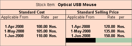

Set Standard Rates
This option gets enabled only after enabling Allow Std. Rates for Stock Items in Inventory Master Configuration. This option helps you specify standard purchase rate and standard sales rates for the item.
The standards are effective from the specified dates and they continue to be used at these rates until the next date, where the standard rate changes.
Note: Standard Rates can also be used for valuation of closing stock.
Behaviour Group
Once you enable Allow Advanced Entries in Masters Behaviour Group option will be enabled.
Options available under Behaviour Group are:
Costing Method
This field will display the List of Costing Method for valuating the Stock Item.
Depending upon the stock item, you can select the costing method for valuating the Stock item.
