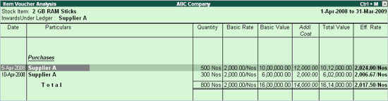

Press Enter on the Party Name or Stock Journal Name to display the transaction-level details on date of goods received/sold, quantities, basic rates, addl. costs, and effective rate for each transaction.

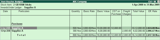

The default screen displays the addl. costs (if any), in a single column. To view the spread of costs, press F12: Configure and select to view Show Addl. Costs.
This brings up the bifurcation of all additional costs.
