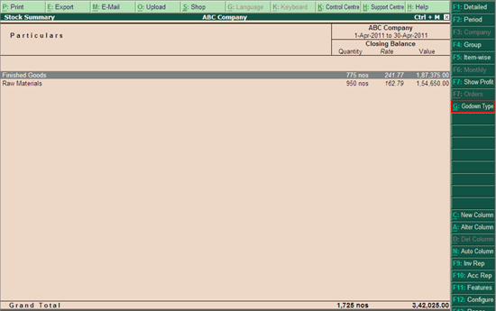

To display the Stock Summary based on various Godown Types
  • Go to Gateway of Tally > Stock Summary.
The Stock Summary report appears as shown below:
  • Click Godown Type button or press Ctrl+G.
Note: This button appears only when the option Maintain Multiple Godowns is enabled in F11:Inventory Features.

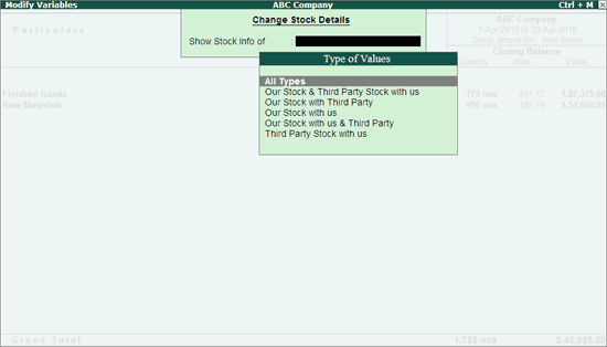

  • Select the stock details from the Type of Values list.
The Type of Values list appears as shown below:

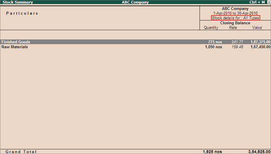

All Types
This report displays the stock including your stock lying with third parties and third parties stock lying with you, as shown:

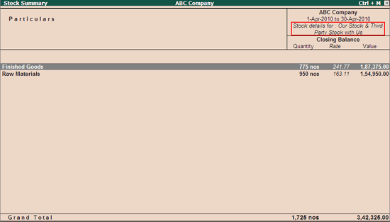

Our Stock & Third Party Stock with us
This report displays the stock including the third party stock lying with you, and excluding your stock with the third parties, as shown:
  • Select the required Stock Group/Item to drill down for further details and other options as discussed in Displaying Stock Summary.

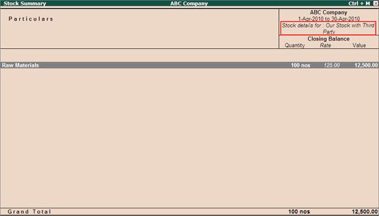

Our Stock with Third Party
This report displays your stock lying with the third parties, such as, Job workers, consignment agents, bonded warehouse, etc., as shown:

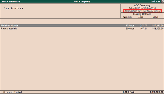

Our Stock with us
This report displays the stock after excluding your stock lying with third parties and the third party stock with you, as shown:
