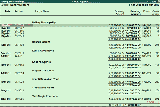

The Bill-Party wise receivables report appears as shown below:
In this report, the list of all bills receivable for every party is displayed.
In the above screen, for the party Bellary Municipality, five reference numbers with the total amount to be received, the due date and the number of days the amount is due is displayed.
Pressing Enter will display the details of the vouchers recorded against a particular reference number.

The Bill-Party wise report for Group Outstandings appears as shown below:
The button options for this report are similar to that of Group Outstandings report except for F12: Configurations.
