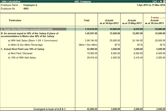

To view the HRA Computation for the selected Employee,
  • Bring the cursor on House Rent Allowance and press Enter
Similarly, the Computation for all the components can be viewed.
