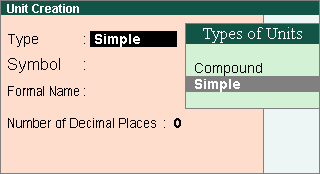

Go to Gateway of Tally > Inventory Info > Units of Measure > Create
The Unit Creation screen is displayed as shown. Now Click on Type field or Press SHIFT + TAB or Press Backspace Key.
Select Compound from the Types of Units and press Enter. The Conversion field will be displayed for creating Compound unit.
