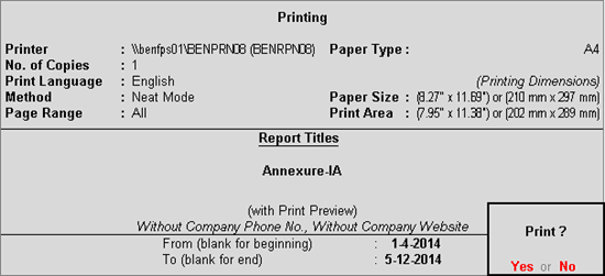

Annexure I-A
To view the Annexure I-A
  1. Go to Gateway of Tally > Display > Statutory Reports > VAT > VAT Form I> VAT Form I -1
  2. Select Annexure Ready and press Enter.
  3. Select Annexure I and press Enter.
  4. Click P: Print Annexure.
  1. Press Enter to print
The print preview of Annexure I-A appears as shown below:
  3. Select Annexure V and press Enter.
  5. In the Print Report screen, enter the period in From and To fields.
  6. Specify the Name and Status/Designation of the signatory to the Form, and the Place and Date
  7. Press Enter to generate the print preview of Annexure V
