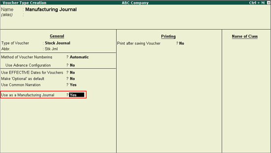

To create a Manufacturing Journal Voucher Type,
Go to Gateway of Tally > Inventory Info. > Voucher Types > Create
Name
Enter the name of the Voucher for ex: Manufacturing Journal
Type of Voucher
Select Stock Journal from the List of Voucher Types
Method of Voucher Numbering
You can select the method of voucher numbering as required.
Use Advance Configuration
Enable the options as required.
For more details refer Creating a Voucher Type with Advanced Configuration
Use a Manufacturing Journal
Set this option to Yes. Once this option is set to Yes, you will be able to record Manufacturing Journal.
You can also alter the existing Stock Journal Voucher type and set Use as a Manufacturing Journal to Yes.
Go to Gateway of Tally > Inventory Info > Voucher type > Alter > Stock Journal
Note : Once the Stock Journal is altered to enable the option Use as a Manufacturing Journal, all stock journal vouchers will be treated as Manufacturing journals.
