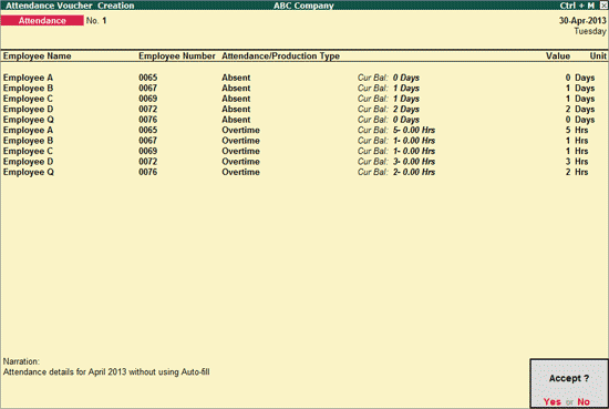

You can use the attendance voucher to enter attendance, overtime, leave or production details. You can enter separate vouchers every day or a single voucher for a given pay period, say a month, with aggregated values. One voucher can store data on all employees, and multiple attendance types.
Attendance Voucher – Manual Entry
  1. Go to Gateway of Tally > Payroll Vouchers > Ctrl+F5: Attendance.
  2. Click on F2: Date to change the date.
  3. From the List of Employees, select the employee whose attendance you want to record.
  4. Select the Attendance/Production Type from the list.
  5. Enter the Value.
  6. Select End of List from the List of Employees.
  1. Press Enter to save.
