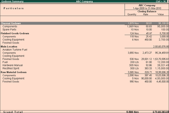

Go to Gateway of Tally > Display > Statements of Inventory > Godowns > Primary
  • Press Alt + F1 for a detailed view.
The Godown Summary screen is displayed as shown
