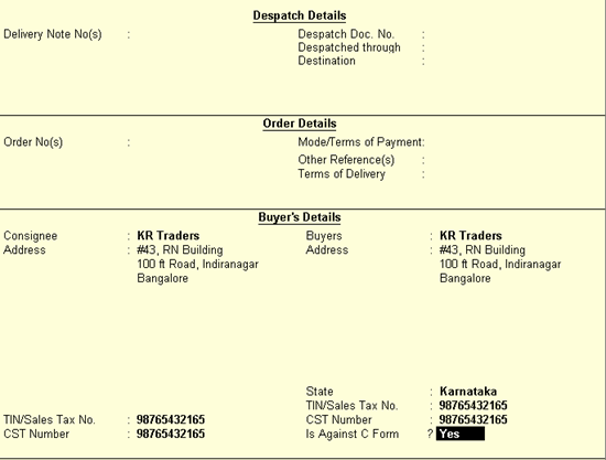

  4. Enter the required details in Party Details screen,
  5. Set the option Is Against C Form to Yes.

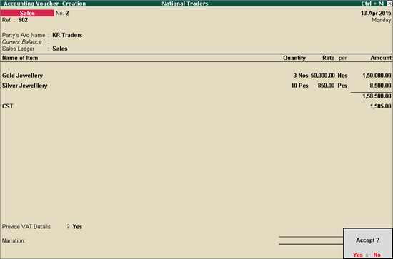

  1. Select the common sales ledger in Sales Ledger field.
Note: A common sales ledger can also be used here
  1. Select the Interstate Sales – Against Form C in Nature of Transaction.
  2. Select the stock items that have multiple CST rates.
Below the stock item, the selected classification will appear along VAT rate and assessable value on which the tax is calculated.
Note: Irrespective of the VAT rate defined in the item master, the rate changes based on VAT Classification selected in the invoice
  1. Enter the Quantity and Rate.
  2. Select common CST ledger.
Note: Alternatively, sales ledgers predefined with a specific rate can be also be created and used in this transaction

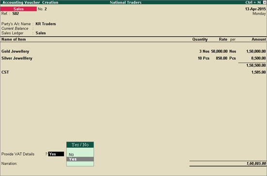

  1. Set Provide Statutory Details to Yes. In Statutory Details screen:
  • Enter Original inv. no. and Date
  • Select C Form in Form to receive
  • Enter Form serial no, Form no, Date
  • Enter the required e-Sugam details
  • Press Enter to save the Statutory Details screen.
  1. Press Enter to save.
