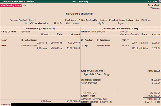

  6. Amount: Amount will be displayed automatically based on the % of Cost Allocation defined for the By-product/Co-product/Scrap produced. Tally.ERP 9 calculates the % of Cost Allocation on Effective Cost
In the above example: Amount of By-Product 1(5,050) = 20,20,000 (Effective Cost) X 0.25\100 (% of Cost Allocation)

Effective Cost
The Effective cost is total of Cost of Components (Consumption) + Additional Cost incurred to manufacture the finished goods & Co-Product/By-product or Scrap
In the above example: 20,00,000 + 20,000 = 20,20,000 is incurred manufacture Item B (Primary Item), By-Product 1 & Scrap
Allocation to Primary Item
The cost allocated to manufacture the Primary Item will be displayed in this field.
Allocation to Primary Item = Effective Cost - Total cost of Co-products/By-Products/Scrap
Effective Rate of Primary Item
This is the rate of the Primary Item Manufactured (finished item).
In the above example: 20,08,890 / 2000 (number of Item B produced) = 1004.45/nos.
