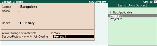

Go to Gateway of Tally> Inventory Info. > Godowns > Create
  1. In the Godown Creation screen, Allow Storage of Materials is automatically set to Yes. Ex: Bangalore.
  2. An additional field Set Job/Project Name for Job Costing is displayed. Press the spacebar in the field and the list of Cost Centres for which Use for Job Costing was set to yes is displayed in the List of Cost Centres sub-screen.
  3. Select the Cost Centre to which the Godown is associated.
  4. Click Yes to Save.
Note: Refer Create a Location for more details on Creating Godown. When the Godown is configured for Job Work cursor will not move to Use for section.
