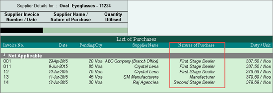

  4. Click F12: Configure and set the options as given below to select the purchase bills multiple nature of purchases.
  5. Set the option Use defaults for excise bill allocations to No to select the purchase bills
  6. Set the option Allow different nature of purchase for excise bills to Yes to select bills of different stages of purchase.
  1. Select the stock item. The Supplier Details screen appears.
  2. Click F12: Configure of Supplier Details screen and set the option Show Nature of Purchase to Yes.
The Supplier Details screen appears with Nature of Purchase column as shown below:
  1. Select the required purchase bills.
The Supplier Details screen with different purchase bills appears as shown below:
