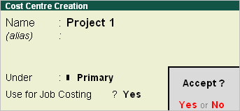

Creating Cost Centres for Job Costing is similar to creation of other Cost Centres. Refer Cost Centres for additional Information.
Go to Gateway of Tally > Accounts Info > Cost Centres > Create
  1. Enter the name of the Cost Centre in the Name field. Eg: Project 1.
  2. In the Under field select Primary from the List of Options.
  3. Set the option Use for Job Costing to Yes. This cost centre will then be available in the drop down for the Job Work Analysis report.
  4. Click Accept to save the settings.
