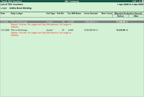

  1. View the un-migrated vouchers report:
  2. Go to Gateway of Tally > Display > Statutory Reports > TDS Reports > Exception Reports > Migrate Tool > Track Migrate Vouchers. Track Migrate Vouchers report is displayed with party-wise total, migrated and un-migrated vouchers.
  1. Select the party to check the reasons for non-migration, and correct the vouchers from Track Migrate Vouchers report screen.

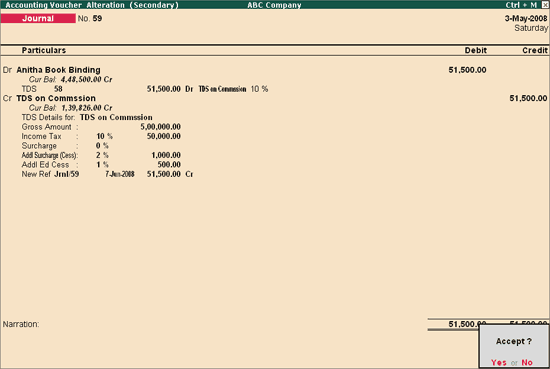

  • Case 6: In the TDS Deduction Entry the Tax Ledger Slected for Tax deduction and  Party Bill Reference Tax Ledger is Different

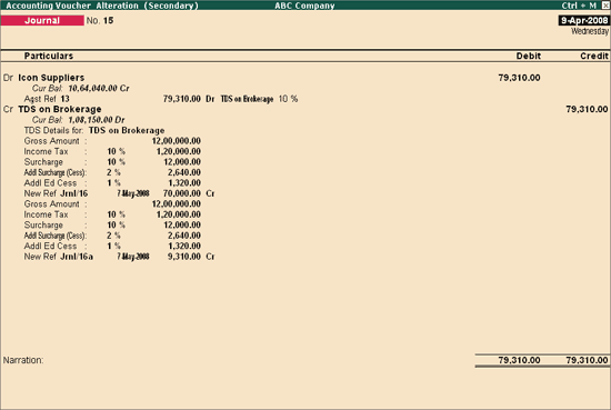

  • Case 9: Voucher is Having Multiple Amounts for Tax Ledger
