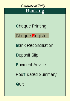

Go to Gateway of Tally > Banking > Cheque Register

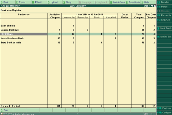

The Cheque Register report screen will appear as shown:

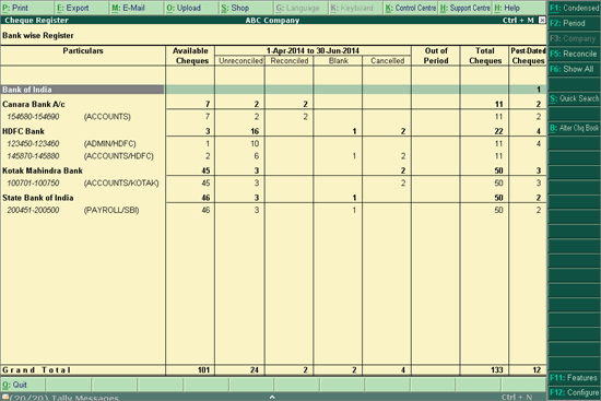

The first level of the Cheque Register report displays all the banks and gives the number of total cheques which are Available, Unreconciled, Reconciled, Blank, Cancelled, Out of Period, and Post-dated.
Users can drill down from any of the columns.
  • To view the break-up of the statistics based on the Cheque Ranges, click F1: Detailed.
  • The period of the report can be changed using the F2: Period option.
  • Using F5: Reconcile button, users can go to the Bank Reconciliation screen for a particular bank.

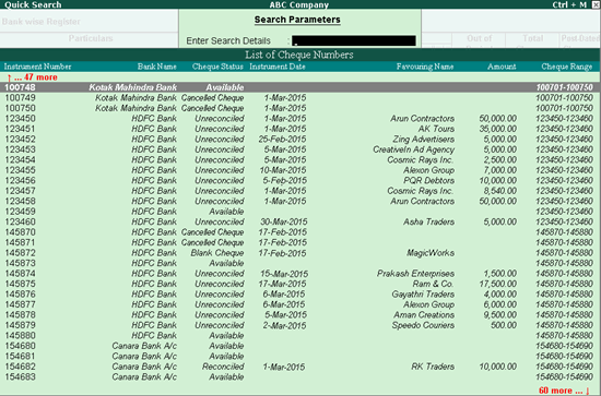

  • To search for a particular cheque’s details, press S: Quick Search. Part of the cheque number can be used to search for a cheque. The search results will have all the cheques which have the search string as shown:

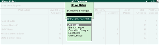

  • To view all the cheques that belong to a particular status like Available, Blank Cheque, Cancelled Cheque, Reconciled and Unreconciled, irrespective of banks and Cheque Ranges, users can click F6: Show All and select the Status.

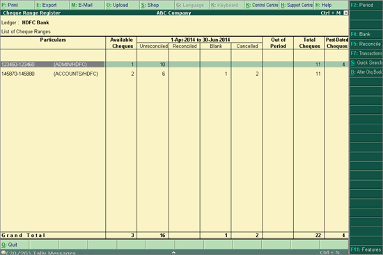

When a bank is drilled down into , the Cheque Register shows the statistics of all the Cheque Ranges of that bank, as shown:
  • To toggle between banks click F4: Bank
  • When the cursor is on a Cheque Range, to reconcile the cheques that are used in that range, click F5: Reconcile. Tally.ERP 9 will list out all the transactions corresponding to the Cheques in that range that have to be reconciled.
  • To view all the transaction details of all the Cheques in the Bank click F7: Transactions.
All the details of every cheque for that bank will be displayed as shown:
  • S: Quick Search option can be used in this screen as well.
  • B: Alter Chq Book option allows you to alter the cheque book details of the transactions

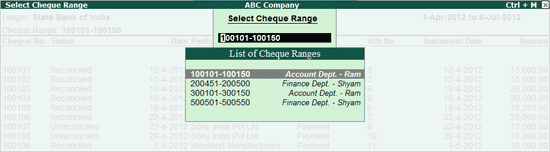

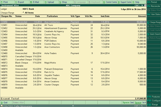

To view all the transactions of all the cheques in a particular range, press Enter on the required cheque range. The Instrument Wise report appears.
  • To toggle between the different Cheque Ranges of a bank click C: Cheque Range
  • To reconcile the unreconciled cheques, click F5: Reconcile.

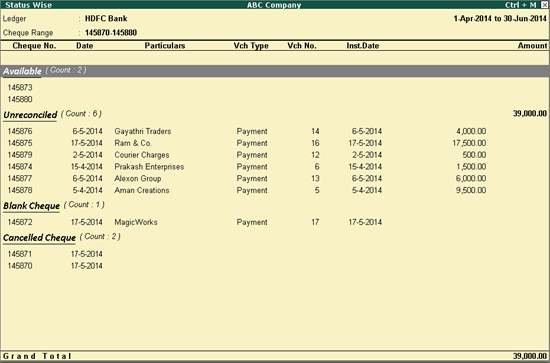

  • Click on F5: Status wise, to get a Status wise statistics of the cheque range.

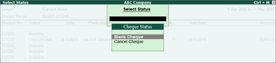

To view all cheques of a particular status, click F6: Status. The Select Status screen will appear where the user can choose to view the report for cheques of a specific status:
  • To change the status of a cheque, select the Cheque Number and click A: Alter Status. The status of Available cheques can be updated as Blank or Cancelled. The Status of Cancelled cheques can be changed to Available.
  • For cheques of the status Available, users can create a voucher from this report. Select a cheque using Spacebar, and click C: Create Voucher to record a transaction for the cheque. The Payment Voucher Creation screen will appear, where you can record the transaction.
  • For cheques that are already used but are not a part of any cheque range, users can define a Cheque Range in the Bank ledger, and can add these Cheque numbers to the Cheque Range. The option R: Refresh Range is used to update the cheque range information for such cheque in the report.

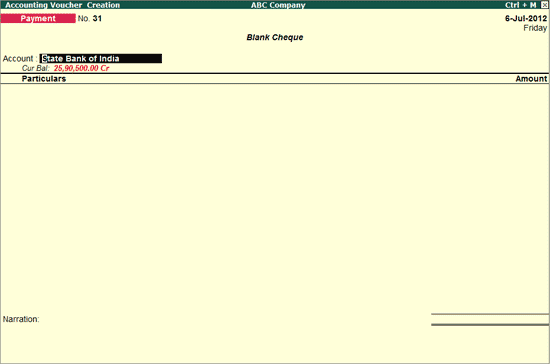

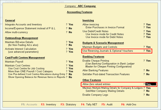

To update a cheque’s status as Blank,
  • The options Use Reversing Journals & Optional Vouchers and Allow Zero valued entries to Yes in F11: Features (F1: Accounting Features).
  • Select an Available Cheque Number and press Alt+A or click A: Alter Status.
  • Select Blank Cheque from Cheque Status as shown:
  • You will be taken to Payment Voucher Creation screen as shown:
  • The voucher will be marked as Blank Cheque.
  • User can change Voucher Number and Amount field. No other field is allowed to be altered.
  • If Amount field is left blank and the voucher is accepted, the status of the cheque in the Cheque Register will be Blank.
  • Once the value is entered in Amount field, the Blank Cheque tag will disappear. The status of the cheque in the Cheque Register will be Unreconciled.

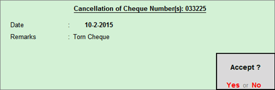

  • Press Alt+A or click on A: Alter Status, and select Cheque Cancelled, give a Date on which the Cheque was cancelled and enter the reason for cancellation in Remarks field.
  • Accept the screen. The Cheque’s status in the Cheque Register will be Cancelled.

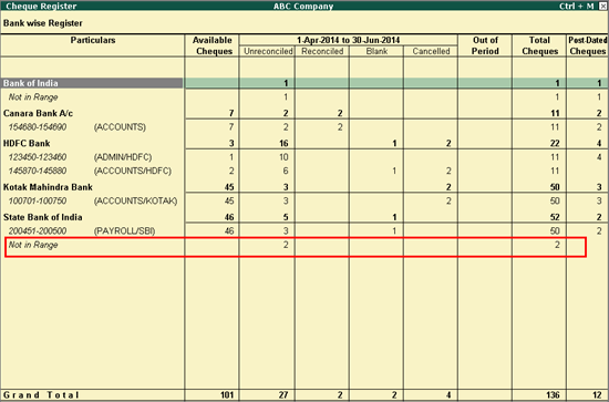

Include Not in Range Cheques
The cheque numbers that are entered manually by the user and which do not belong to any Cheque Range can be brought to the Cheque Register report by setting this option to Yes. This way all the cheques used can be managed from a single place.
