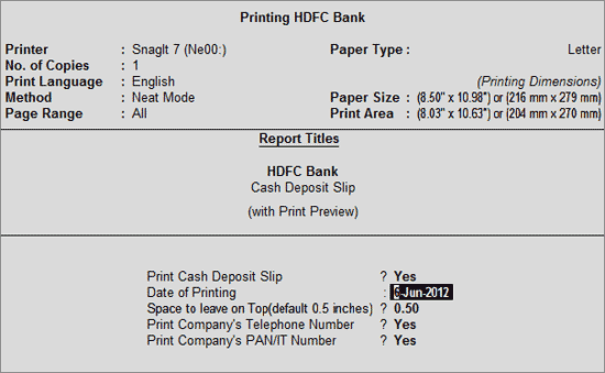

The Printing Cash Deposit Slip screen appears.
  • Date of Printing: The date that has to be printed on the Cash Deposit Slip has to be specified in this field. By default, the current system date is displayed. Usually, this date will be the date on which the actual deposit of the cash into the bank will be made.
  • Space to leave on Top (default 0.5 inches): This is the space between the top of the page and the Title (First Line on the page). User can specify the dimension as per requirement.
  • Print Company's Telephone Number: Set this option to Yes to print the Company's Telephone Number. The Telephone Number specified in the Company Creation screen will be captured.
  • Print Company’s PAN/IT Number: The PAN or IT Number specified in the F11: Features (F3: Statutory & Taxation) will be captured. By default, this option is set to No.
  • Click on Yes or Press Y or Enter to Accept.

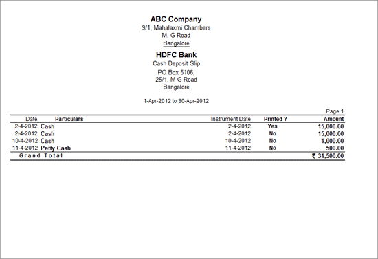

Printing Cash Deposit Slip Report
To Print the Cash Deposit Slip Report,
  • Go to Gateway of Tally > Banking > Deposit Slip > Cash Deposit Slip.
  • Select required Bank account from List of Bank.
  • Click Print or Press Alt+P.
  • Click No or Press N or Esc to set the other options as follows:
  • Print Cash Deposit Slip: Set this option to No to print the Cash Deposit Slip report.
  • Space to leave on Top (default 0.5 inches): This is the space between the top of the page to the Title (First Line on the page). User can specify the dimension as per requirement.
  • Show Remarks also: Set this option to Yes to display the Remarks in the report.
  • Accept to Print.
The Cash Deposit Slip Report is displayed as shown:
