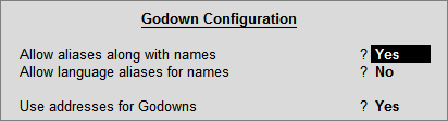

In the Godown Creation screen, press F12: Configure (Godown Configuration) screen is displayed as shown.
  1. Use Addresses for Godowns: Setting this option to Yes enables the Address field in Godown Master
