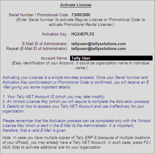

Activating Single Site Account
To activate a single site account
  1. Start Tally.ERP 9.
  2. Click A:Activate License in the Startup screen.
The Activate License form appears as shown below:
  1. Enter the details in the Activate License form, and press Enter. A confirmation message appears on successful activation.
To unlock the license file see, Unlocking License.
Note: The account related information like serial number, activation key, unlock key, and so on is sent to the e-mail ID specified in the Activate License form.

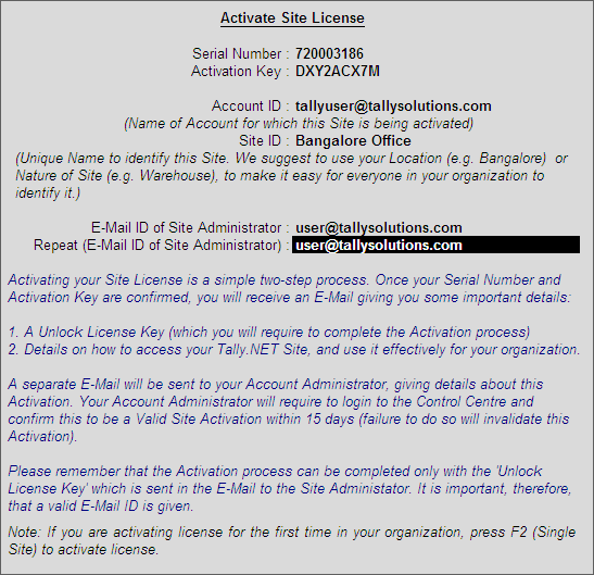

Activating Multi Site Account
To activate the multi site account
  1. Click F2: Multi Site in the Activate License screen.
 The Activate Site License form appears as shown below:
  1. Enter all details in the Activate Site License form, and press Enter.
Note: Use the existing Account ID to activate the new/subsequent sites.
The User Resolution screen to activate a new site appears as shown below:
  1. Click Create a new account or Add to existing account.
  2. The option Create a new account creates a new account for the serial number.
  3. The option Add to existing account opens the User Resolution screen as shown below. This will add the serial number to an existing account.
  1. Click Create a new Site in the User Resolution screen to create new site with the Site ID specified in the activation screen, or click Reactivate existing Site to reactivate an existing site.
A confirmation message is displayed on successful activation.
Note: The account related information like serial number, activation key, unlock key, and so on is sent to the e-mail ID specified in the Activate Site License form.
