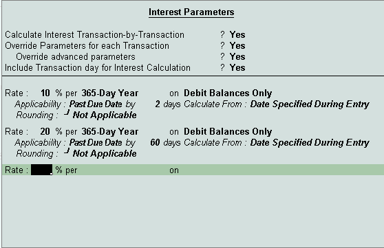

In the Interest Parameters screen of the party ledger,
  1. Set Calculate Interest Transaction-by-Transaction to Yes to calculate interest for each transaction.
  2. Set Override Parameters for each Transaction to Yes to display the Interest Parameters screen while recording the transaction. The defined parameters can be modified during voucher entry.
  3. Set Override Advanced Parameters to Yes.
  1. Set the option Include Transaction Day for Interest Calculation? to Yes to calculate interest from the date of transaction.
  2. Enter the rate of interest in the field Rate.
  3. Select the Interest Style, as required. The rate of interest will be calculated on the basis of the interest style applied.
  4. Select the balance on which the interest has to be calculated. Interest can be calculated on credit balance, debit balance or both credit and debit balances.
  5. Select the applicability of the interest as required. If Past Due Date is selected, then the number of days after which interest has to be applied can be specified.
  6. In the Calculate From field, select the date from which interest is applicable.
  7. Select the rounding method applicable from the Rounding Methods list. The amount can be rounded off normally or upward or downward. If you do not want any rounding method, select Not Applicable.

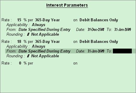

  8. Define interest parameters for different slabs of interest rate, as required.
The Interest Parameters screen appears as shown below:

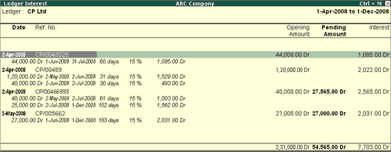

To view the report on Outstanding balances,
  1. Go to Gateway of Tally > Display > Statements of Accounts > Interest Calculations > Ledgers
  2. Select the required ledger.

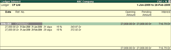

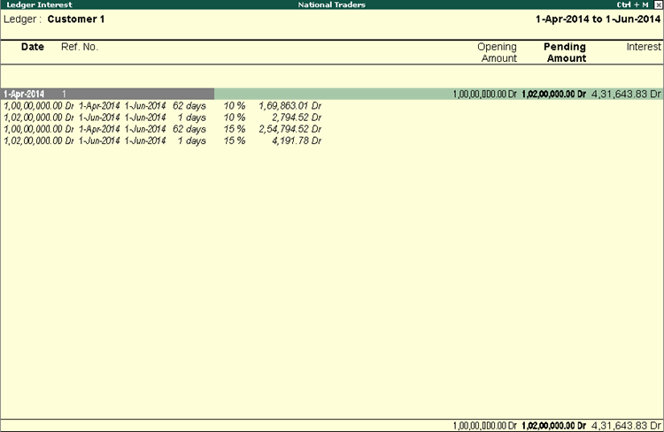

Report on Interest Calculated on outstanding transactions/bills
Press F1: Detailed to view the calculation and period.
Note: In case if part of the amount is settled, the interest is calculated on the remaining balance.
Calculate From Dates Specified during Voucher Entry
In the party ledger master, Set the Interest Parameters for the ledger to calculate on Date Specified During Voucher Entry.
While recording an voucher entry/invoice, set the Interest Parameters as shown below:

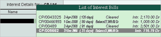

  • Credit the ledger Interest Received grouped under indirect income
When you debit the party account, a list of bills for which interest applicable pops up. Select the bills to adjust. Note that even cleared bills appear.

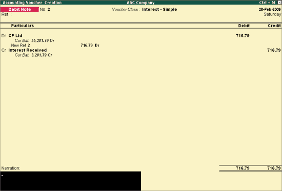

Select  the respective interest bills from the list . The debit amount is filled up with the total. Select New Ref in the bill-wise allocation. In the interest sub-screen, ensure that the rate of interest is 0. Now, Credit Interest Received. The amount is already filled in.
Your voucher will resemble the one below:

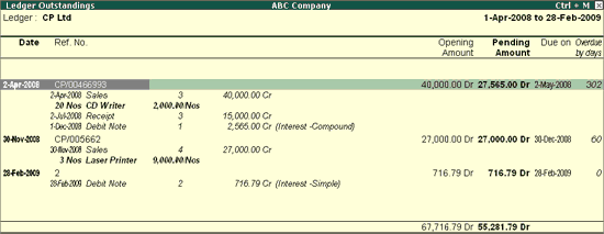

The Ledger Outstandings will be as shown below:
The Bill reference CP/00466993 is the invoice onto which interest has been compounded.
A new Reference no 2 has been created for Simple Interest due from CP Ltd.
