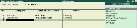

Go to Gateway of Tally> Accounts Info.> Cost Centres> Create (under Multiple Cost Centres)
 This is a quick way to create multiple cost centres under a single Cost Category at a time.

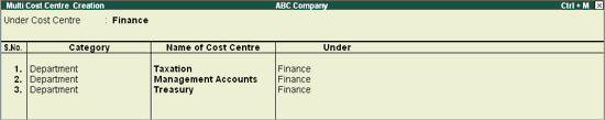

Under Cost Centre
Select a particular Cost Centre as the parent cost center, if you wish to create multiple cost centres under it.
Category
Select the Category under which the Cost Centre will be created from the List of Categories or create a new category by pressing [Alt+C]
Name of Cost Centre
Enter the name of the new cost centre. The alias facility is not available in this mode. Select single alter to give aliases to Cost Centres created in multiple mode.
Under
Select the parent Cost Centre from the List of Cost Centres. The list displays only the Cost Centres that belong to the selected Category.
