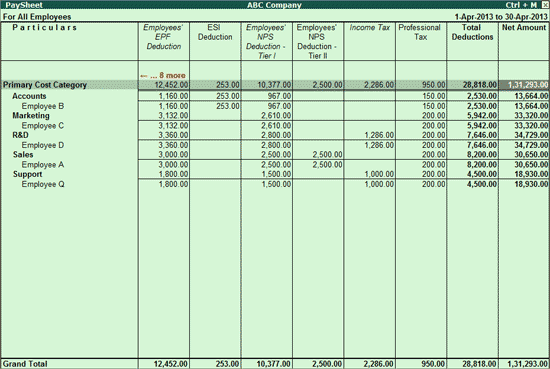

  1. Go to Gateway of Tally > Display > Payroll Reports > Statements of Payroll > Pay Sheet
  2. In the Employee Filters screen:,
  3. In the Name of Category field select the required Employee Category from Employee Filter
  4. In the Name of Employee Group select the required Employee Group from the List of Employees / Groups. The Pay Sheet appears.
The Pay Sheet is displayed as shown:
  1. Scroll towards the right to view other details.
