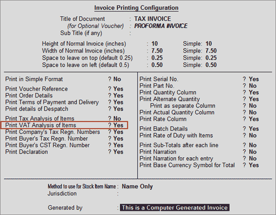

Press Page Up key to view this tax invoice in alteration mode. Press P: Print button (Alt+P) to print the invoice.
Click on F12: Configure button and set the option - Print VAT Analysis of Items to Yes
Accept the Invoice Print Configuration.
The print preview of Tax Invoice displays as shown:
