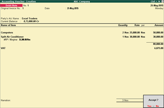

To create a debit note for taxable goods with specified VAT rate in Company VAT Details screen
1.     Go to Gateway of Tally > Accounting Vouchers > Crl+F9: Debit Note.
2.     Enter the Original Invoice Number and Date of the purchase invoice against which the debit note is recorded.
3.     Select the required Party’s A/c Name from the List of Ledger Accounts.
5.     Select the common purchase ledger.
6.     Select the required taxable stock items.
7.     Enter the Quantity and Rate. The amount is automatically displayed in the Amount field.
8.     Select the required common VAT ledger.
The debit note screen appears as shown below:
9.     Press Enter to save.
