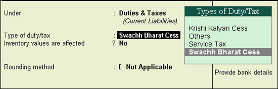

To create a Swachh Bharat Cess ledger
1.     Go to Gateway of Tally > Accounts Info. > Ledgers > Create.
2.     Enter the ledger Name.
3.     Select Duties & Taxes as the group name in the field Under.
4.     Select Swachh Bharat Cess as the Type of duty/tax.
5.     Set Rounding method, as required.
6.     Press Enter to save.
Note: If you have created a Swachh Bharat cess ledger with the Type of duty/tax as Others, you can change the same to Swachh Bharat Cess.
