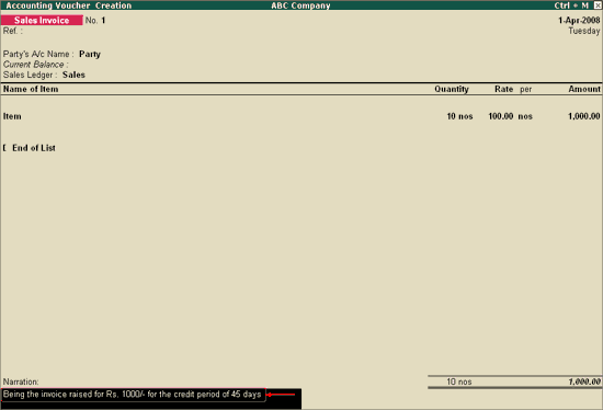

Enable Allow narration in voucher to give a common narration for voucher.
A common narration screen for voucher appears as shown below:

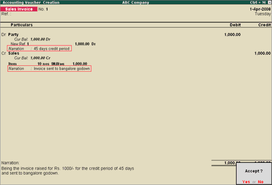

Enable Provide narration for each ledger in voucher ? if you want to give a separate narration for each entry of a voucher. This would be applicable for a multiple entry voucher where you want separate details for each entry.
The narrations for each entry appears as shown below:
For Delivery Note, Receipt Note, Sales order, Purchase order, Physical Stock, Stock Journal, Rejection In and Rejection Out, the option Provide narration for each ledger in voucher ? is not available.

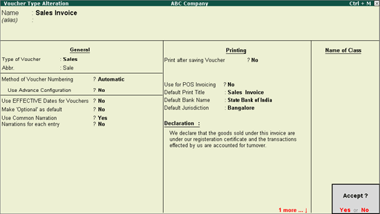

Create a voucher class in the Name of Class field, if required.
The completed Voucher Type Creation screen appears as shown below:
Press Enter to save.
For more details on voucher class, see Voucher Class.

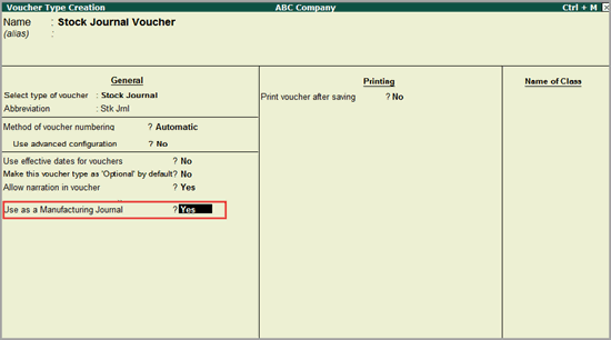

While creating a Stock Journal Voucher Type, the option Use Manufacturing Journal is enabled.
The Voucher Type Creation screen appears as shown below:
