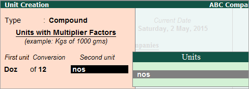

The Unit Creation screen is displayed as shown. Now Click on Type field or Press SHIFT + TAB or Press Backspace Key.
Select Compound from the Types of Units and press Enter. The Conversion field will be displayed for creating Compound unit.
Field Information:
First unit: Select the First unit from the Units List. In the above example, Dozen will be the First Unit.
Conversion: Specify the conversion Factor. In the above example, Conversion factor will be 12.
Second unit: Specify the Second Unit from the Units List. In the above example, Number will be the Second Unit. This unit is also called Tail Unit.
Use CTRL + A or Accept the Screen for Saving of Compound Unit Creation.
