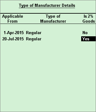

If your business involves dealing with only goods taxable at 2%, then provision can be made to set this during excise registration.
To configure as a manufacturer of only 2% goods,
Click F12: Configure from the Excise registration details screen.
Enable the option Enable as manufacturer of only 2% goods.
Press Ctrl+A.
Enable the option Deals only with 2% goods.
Click L: Details to define the date of applicability for dealing with 2% goods.
Enter the date in the field Applicable from.
Select the Types of Manufacturer.
Select Yes in the field Is 2% Goods.
Set applicability details for the next period, if required.
Press Enter to go to the Excise registration details screen.
