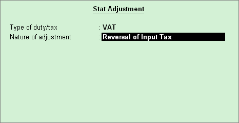

1.     Go to Gateway of Tally > Accounting Vouchers > F7: Journal.
2.     Click J: Stat Adjustment button to open the Stat Adjustment screen.
3.     Debit an expense ledger created under the group Indirect Expenses.
4.     Credit the VAT ledger created under the group Duties & Taxes with Type of duty/tax selected as VAT.
o      Enter the Rate and  Assessable Value in VAT Details screen.
o      Press Ctrl+A to accept the VAT Details screen.
    The completed screen appears as shown below:
5.     Press Enter to save.
