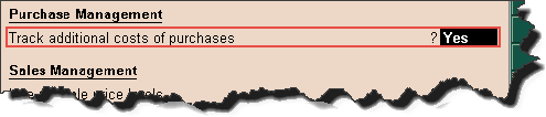

Enabling Additional Costs of Purchase
In F11: Features (F2: Inventory Features) under Purchase Management, set Track additional costs of purchases to Yes.

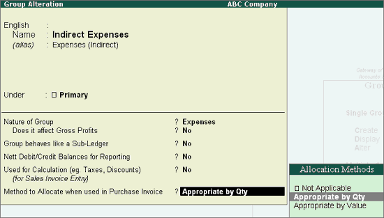

The following set-up activity is required to appropriate the additional costs:
●     Alter the Parent Group of the expense ledger accounts, e.g. Indirect Expenses. (Go to Gateway of Tally > Accounting Info > Groups >Alter > Direct Expenses).
●     You will find a new option - Method to Allocate when used in Purchase Invoice.
●     If you want to appropriate the ledger accounts under this group to stock items either by Quantity or value, you must select the respective option. For example, select Appropriation by Qty.
Note: To get the option Method to Allocate when used in Purchase Invoice, enable the option Record purchases in invoice mode in F11: Features (F1: Accounting Features)

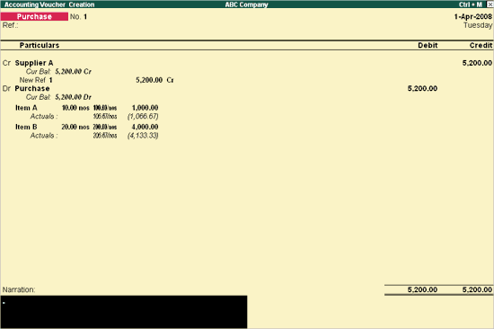

Creating Purchase Entry
Purchase entry in As Voucher mode: The additional cost details have to be filled in after the allocation of each purchase item.

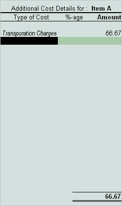

While creating the Purchase Voucher, once after giving the Quantity and Rate in the Inventory Allocations, press Enter button on the Amount column, Additional Cost Details screen will be displayed.
Type of Cost
Select the expense ledger from the List of ledgers Accounts.
% age
Additional costs can be entered in terms of percentage also. For example, 1%, 2% etc. You can also skip the percentage field to enter the amount directly.
Amount
You can enter the amount of additional cost directly or if the percentage is entered, then amount will be calculated automatically.
Note: If there are two or more items, then for items, the ‘Additional Cost Details’ screen will be displayed.

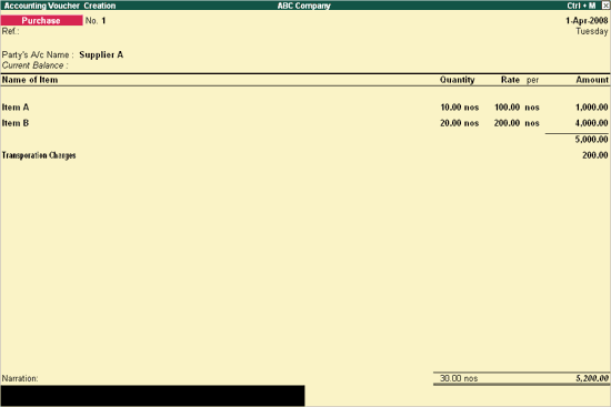

Purchase entry in As Invoice mode: The treatment of additional costs on stock items is automated.

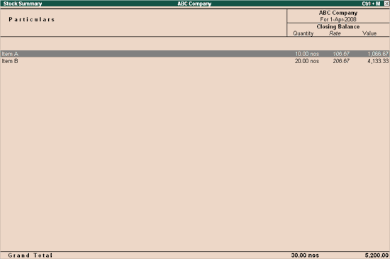

Report on Additional Cost Details
The reports on appropriation of additional costs/ expenses can be viewed in the Stock Summary.
Go to Gateway of Tally > Stock Summary.
Let us consider as an example, the appropriation calculation for Item A.
Total of Expenses ledger = Rs.  200
Total of no of quantities = 30
Number of quantities of Item A = 10
200 / 30 * 10 = 66.66
Total amount + additional charges
1000 + 66.66 = 1066.67/-
