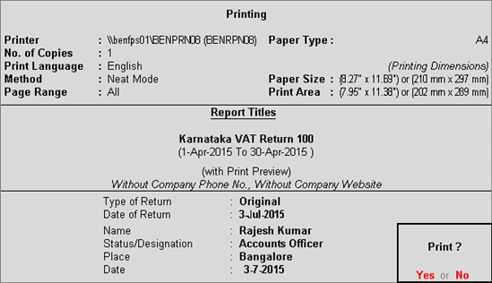

After all the required changes including adjustments and payments are made, you need to save the report before generating and printing the returns.
To save the report
1.    Press F6: Save.
2.    Click Yes in Do you want to Save the Return message.
3.    Press Ctrl+P (Print Form button) and provide the relevant details in the Printing screen
4.    Press Enter to print.

Declaration
Displays the Name, Status/Designation, Place and Date specified in Print Report screen of Form VAT 100 in respective fields of this section.
