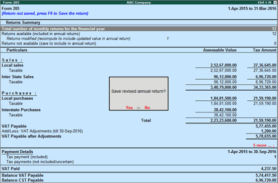

1.    Click F5: Recompute. The buttons F6: Overwrite and F7: Save as Revised appear once the return is recomputed.
2.    Click F7: Save as Revised to overwrite the existing return details with modified details. A confirmation message appears as shown below:
3.    Click Yes to save the return as revised.
