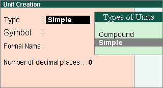

1.    Go to Gateway of Tally > Payroll Info. > Units (Work).
2.    Select Type as Simple.
3.    Enter the Symbol for the Unit.
4.    Enter the Formal Name.
5.    Provide the Number of Decimal Places, as applicable.
6.    Press Enter to save.
Similarly, you can create the other payroll units such as Minutes, Hours, and Pieces.
