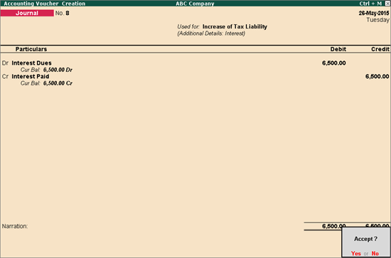

To record journal entry to account for interest payable
2.    Click J: Stat Adjustment. In the Stat Adjustment Details screen,
o     Select the option VAT in the field Type of duty/tax.
o     Select the option Increase of Tax Liability in the Nature of Adjustment field.
o     Select Interest for the option Additional Details.
o     Press Ctrl+A to save and return to the voucher creation screen.
3.    Press Enter to return to voucher.
4.    Debit an expense ledger created under Indirect Expenses with option Is VAT/CST Applicable? set to Not Applicable.
5.    Credit the ledger created under Current Liabilities. The completed screen appears as shown below:
6.    Press Enter to save.
