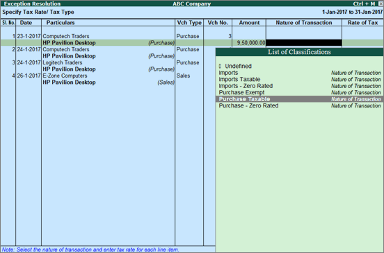

Tax rate/tax type not specified
Displays the count of transactions for which the rate or tax type is not selected in the item/ledger master.
To resolve this exception
1.    Select the exception Tax rate/tax type not specified.
2.    Press Enter. All the transactions of the exception type are displayed. The Exception Resolution screen appears as shown below:
3.    Select the Nature of transaction, if not provided.
4.    Enter Rate of Tax, as required for each transaction.
5.    Press Enter to save.

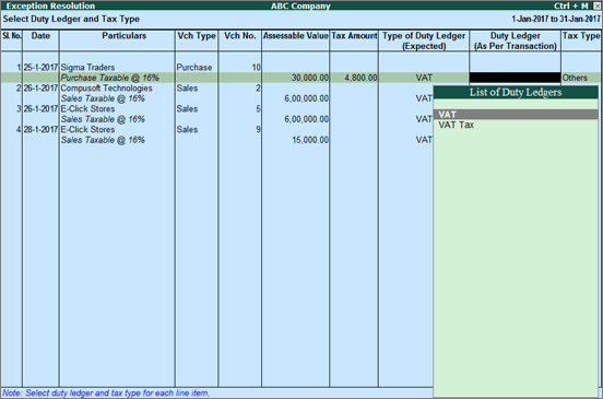

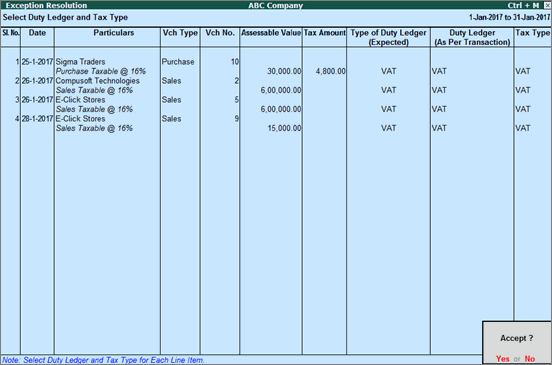

Incorrect tax type selected in tax ledger
Displays count of transactions in which type of duty is invalid.
1.    Select the exception Incorrect tax type selected in tax ledger.
2.    Press Enter. All the transactions of the exception type are displayed, as shown below:
3.    Select the tax type for each transaction.
The Exception Resolution appears as shown below:
4.    Press Enter to save.
