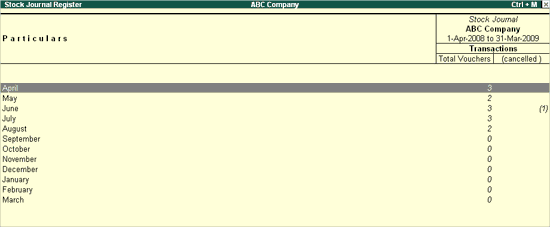

     Go to Gateway of Tally > Display > Inventory Books > Stock Transfers. The Stock Journal Register appears as shown below:
The total number of vouchers and cancelled vouchers for each month of the Voucher Type - Stock Journal is shown in the default report.
To view the Stock Journal Vouchers for any month, press Enter on any month, all the vouchers of that month will be displayed.
