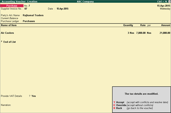

6.    Select the required stock item. Enter Quantity and Rate. The purchase invoice appears as shown below:
7.    Press O to override with the nature of transaction selected in the invoice, and save.
