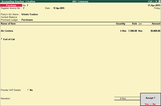

To record a purchase transaction from URDs
2.    Click F12: Configure. In the Voucher Configuration screen
o     Set the option Allow modification of Tax Details for VAT? to Yes.
o     Press Ctrl+A to save and return to invoice.
3.    Enter the Supplier Invoice No. and Date if any.
4.    Select the supplier ledger in Party’s A/c Name field.
5.    Select a common purchase ledger in which the option Is VAT/CST Applicable is set to Applicable, and Set/Alter VAT Details is disabled.
o     Select Purchase From Unregistered Dealer as Classification / Nature in the VAT Classifications Details screen.
o     Press Enter to save.
6.    Select the required stock item. Enter Quantity and Rate. The purchase invoice appears as shown below:
7.    Press Enter to save.
