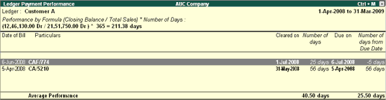

The Ledger Payment Performance screen is displayed as shown:
The Ledger Payment Performance statement displays the receivable turnover in days. This is the balance outstanding in relation to the total sales made multiplied by the total number of days in the period. This ratio should be used in combination with the Average Performance of actual payments and the payment history of the customer to assess how long he might take to pay the outstanding balance.
The Actual payment history is given in the table for each invoice that was paid by the customer. It shows when the invoice was paid, how long it was due and what was the delay in payment. The customer's average performance is shown at the bottom of the screen.
